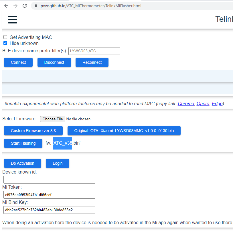

Mi Token:
cf975ae0953f047b1df66ccf
Mi Bind Key:
dbb2ae527b0c782b0482eb130de853e2
7:05:54 PM: Searching for devices
7:06:04 PM: NotFoundError: User cancelled the requestDevice() chooser.
7:06:04 PM: Reconnect 1 from 5
7:06:33 PM: Searching for devices
7:06:57 PM: NotFoundError: User cancelled the requestDevice() chooser.
7:06:57 PM: Reconnect 1 from 5
7:07:12 PM: Searching for devices
7:07:28 PM: Connecting to: LYWSD03MMC
7:07:39 PM: Hardware Revision String: B2.0
7:07:39 PM: Detected Mi device
7:07:39 PM: Connected
7:08:01 PM: Activating now, please wait...
7:08:05 PM: Registration successfull
7:08:05 PM: Send Login, please wait...
7:08:05 PM: Received device infos are correct
7:08:06 PM: Login successfull
7:09:56 PM: Load firmware file 'ATC_v38.bin'...
7:09:56 PM: File: ATC_v38.bin
7:09:56 PM: File size: 67252 bytes
7:09:56 PM: Count: 4204
7:12:19 PM: Start DFU
7:13:24 PM: Update done after 64.31 seconds
7:13:31 PM: Disconnected.
